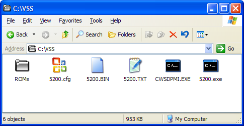

You should first use WinZip or another ZIP file-management utility to unpack all of your files. Next, you should create a folder on your hard drive for your emulator (call it VSS, perhaps). In your VSS folder, create a subfolder named ROMs and place your "naked" game ROMs inside this folder; you don't need to zip them first. Don't run the Setup.exe program for Regal Beagle 2000 yet. At this point your VSS folder should look something like the following:

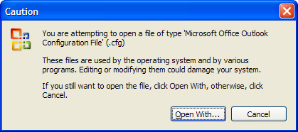

1. The first thing we need to to is set up the ROM file path to make using 5200.EXE easier. Right-click the 5200.CFG configuration file in the VSS folder and select Open With from the shortcut menu.
You might or not see the preceding Caution dialog box. If you do, then click Open With.

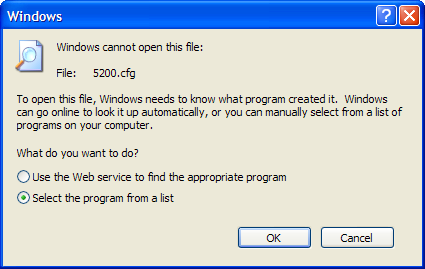

If you see the preceding Windows dialog box, then choose Select the program from a list and then click OK to continue.

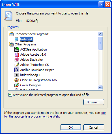

In the Open With dialog box, select Notepad, optionally select Always use the selected program to open this kind of file, and then click OK.

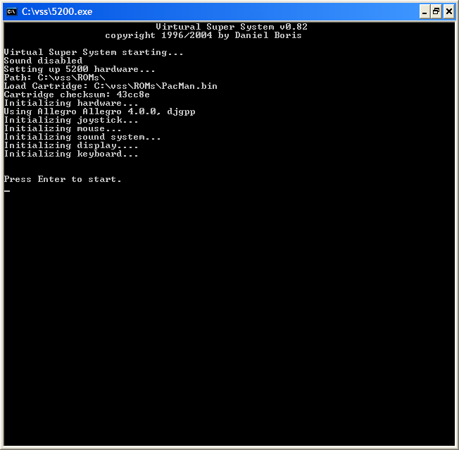

5. Type the command 5200 rom_name.bin, where rom_name is the name of the Atari 5200 game ROM. While the names of the ROM files are not case-sensitive, the .BIN extension must be appended to the file name. However, you don't have to add the .EXE to 5200.EXE. Consequently, the command strings 5200.EXE pacman.bin and 5200 pacman.bin are equivalent.
6. Before the game starts you'll see the following preliminary screen:
7. Press ENTER to start the game. By default the game will run full-screen.

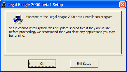

In the first screen of the Regal Beagle 2000 beta1 Setup dialog, press OK to continue.

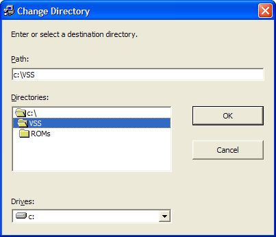

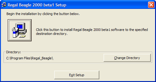

In the second screen of the Regal Beagle 2000 beta1 Setup dialog box, be sure to click Change Directory. You need to ensure that you install Regal Beagle 2000 into the same directory as your Virtual Super System files.
 In the Change Directory dialog box, browse to the location of your Virtual Super System files and click OK.

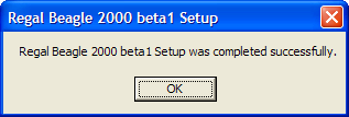

In the Choose Program Group dialog box, rename the Start menu program group name as appropriate and then click Continue. If all goes well, the installation process will complete successfully and display the following dialog box.

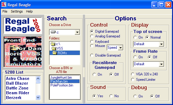

If you have properly configured the 5200.CFG file with the path to your ROMs directory, then you should not have to mess around too much with the Search portion of the Regal Beagle dialog box. You should see your available Atari 5200 ROMs in the Choose a BIN or A78 file list box. Note that the entry for PolePosition.bin in the above screen capture is for illustration purposes only; as of release 0.82, VSS does not support Pole Position.
I have found that most Atari 5200 games tend to run much too quickly on my 2.8 GHz computer. If you own a fast computer, then you might want to select the Speed Limiter radio button in the Display portion of the Regal Beagle dialog box.
In the Control portion of the Regal Beagle dialog box, select a control type. For simplicity's sake, you might want to begin by selecting Keyboard.
You can use the Yes and No radio buttons in the Sound portion to toggle sound. If you run Windows XP and are experiencing sound problems with your Atari 5200 games, then please see the troubleshooting portion of this tutorial for a solution.
Make sure you save your settings! Click Settings => Save to save your Regal Beagle settings.

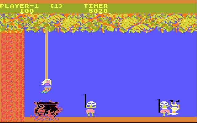

To play an Atari 5200 game ROM, open Regal Beagle and double-click a game ROM in the Choose a BIN or A78 file list box. Alternatively, as long as your ROM directory is properly selected, you can start a game by double-clicking an entry in the 5200 List list box. The following dialog box appears:
Press ENTER to start the game. By default, the game will run full-screen.
