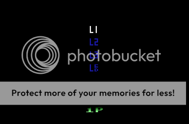

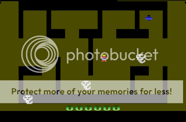

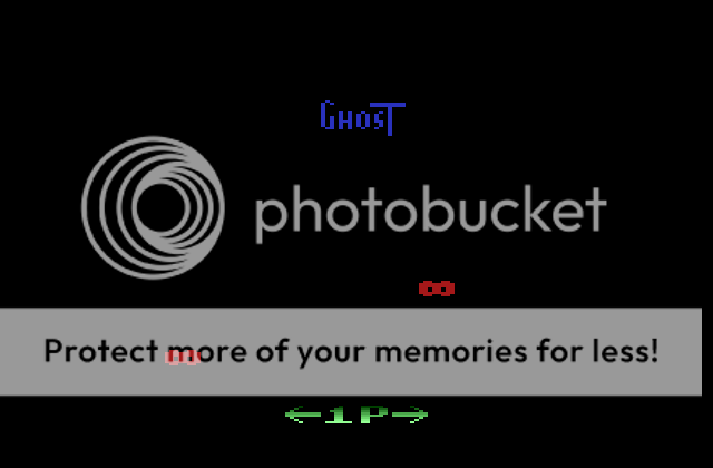

Lodmot Posted April 18, 2012 Share Posted April 18, 2012 (edited) Alright. After a long hiatus of no new games, here's my next one finally. This is my first game that makes use of the DPC+ kernel. The object is to shoot the ghosts floating around. As you progress, the ghosts will get faster and smarter. As of now, the game is nearly finished. I made music for each of the three levels, and the player is able to instantly switch between music and SFX, like in Game Catcher. Update - 4/24/2012 After messing around a bit with the code, I've managed to fix the levels system. Before there were 5 level variations, now there are 8. Now if you make it past level 4, the ghosts will deliberately chase you down, slowly at first, then faster and faster as you progress. Because these extra levels require 3-digit scores in order to activate them, they won't activate during 2P Versus mode. (But they will work in 2P Co-Op mode) Hope you like this new build. ^^ Here's some screenshots, and the current build is attached so you can try it out: default.bas.bin Edited April 24, 2012 by Lodmot 1 Quote Link to comment Share on other sites More sharing options...
Byte Knight Posted April 18, 2012 Share Posted April 18, 2012 Good start! Looks like Night Stalker or Berzerk. I've often thought about making a Night Stalker-like game with DPC+. Unfortunately the missiles do not work very well in DPC+, as they take on colors of other sprites and one of the missiles (can't remember if it's missile0 or missile1) eventually stops working completely. You're probably better off using the ball sprite for your bullets. Quote Link to comment Share on other sites More sharing options...
+SpiceWare Posted April 19, 2012 Share Posted April 19, 2012 Unfortunately the missiles do not work very well in DPC+, as they take on colors of other sprites Missiles always share the color of the corresponding sprite. Likewise the ball always shares the color of the playfield. Quote Link to comment Share on other sites More sharing options...
Byte Knight Posted April 19, 2012 Share Posted April 19, 2012 Missiles always share the color of the corresponding sprite. Likewise the ball always shares the color of the playfield. Yes, and I wish the missiles would just take on one color. The problem is that when you have a multi-colored sprite, the missile will take on multiple colors if it's more than one pixel high, as seen in Lodmot's Ghost game. Unfortunately the COLUM0 and COLUM1 commands do not seem to help... Quote Link to comment Share on other sites More sharing options...
Lodmot Posted April 19, 2012 Author Share Posted April 19, 2012 (edited) Yeah, I had a really tricky time trying to get the bullets to shoot. In earlier builds of the game, they wouldn't even fire at all. The way they work now is the best I've been able to get them. Also, to get the 2nd player to collide into walls, I had to resort to using the ball object as a sort of collision mask for the 2nd player, because the collision function doesn't seem to play nicely between players 2-9 and the playfield. Collision against playfield pixels is tricky anyway. I can't seem to do it without there being a way for the player to fly through the walls. xDD Edited April 20, 2012 by Lodmot Quote Link to comment Share on other sites More sharing options...

Lodmot Posted April 19, 2012 Author Share Posted April 19, 2012 (edited) Just tested this game on real hardware today. The playfield is very fidgety. It keeps scrolling up and then re-appearing... Everything else seemed to work fine though. Anyone have any ideas as to what it could be? If I have to, I'll make two separate versions of the game for emulators and real hardware. EDIT: Nevermind, figured it out. Game works great on real hardware now! XD Edited April 19, 2012 by Lodmot Quote Link to comment Share on other sites More sharing options...
