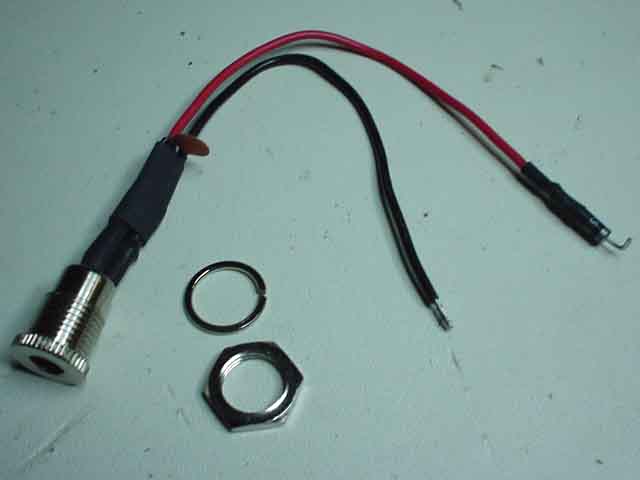

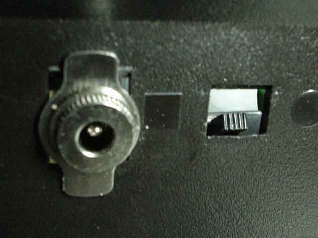

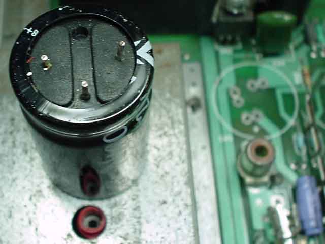

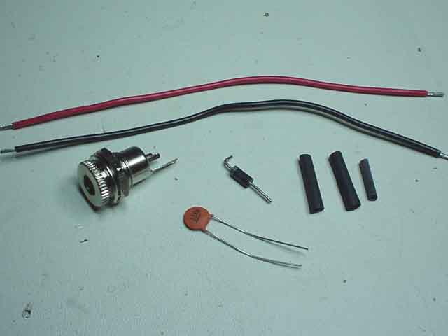

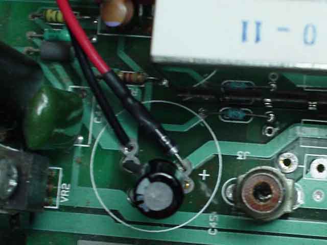

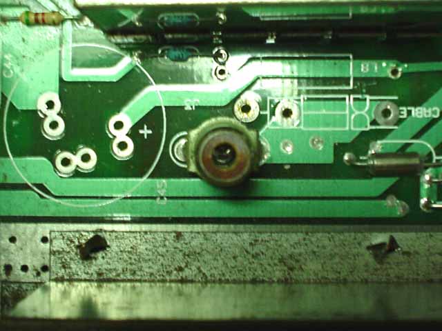

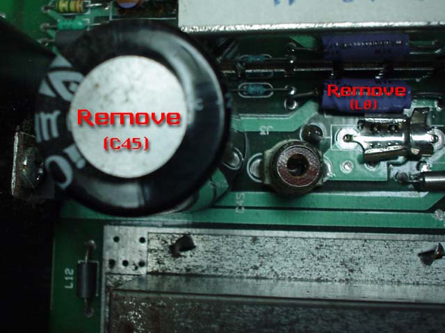

This is a followup for Mitch's instructions on how to get rid of the pesky switchbox on the 4 port Atari 5200.
See:
http://www.atariage....pic.php?t=17441
I did mine slightly differently ... 8)
Hopefully this will help someone else who was confused by the text-only instructions. :)

if i just want to make a switch box, i need the video cable from that box to a regualr RF atari box right, (from the one listed in FAQ)? anyone make these boxes could give me a hand?

Can I use a 47uF 16V cap for this? I've only got that one and a 470uF 35V handy :)

For a change cell phone Shack actually had something I was looking for (the cap), so I finally did this to the first 5200. It works great, goodbye switchbox!!
Thanks CPUWIZ and Mitch! :D

Radio Crap had everything but the correct diode when I modded my 5200. I went back to finish up a Supercharger, and when I asked them to look up their catalog number for the 74HCT32, they were like "Invalid SKU". When I asked for something else for a different mod, all the salesmen started to avoid me like I had AIDS or something. Oh, I know what it was...I asked for a 10K x2 pot to replace the volume control in my classic game boy. The dude showed me a pot that was three or four inches long and an inch in diameter. I know the Game Boy is enormous, but geez, it's not that big. And he starts to tell me how that part would work...yeah right, it won't even fit the stupid case!
After that, the salespeople leave me alone when I walk in there. Trst me--unless I need batteries ('cause the do have decent batteries), I ain't setting foot in there again.
I just can't believe how naive some people are!
Anyway, I got a larger diode than what Mitch used. It had all the same specs, but it was rated for three times the current. Everything else they had, but I bet our local supplier would have been a bunch cheaper. I'm going down there next week to see what they've got.
Yeah, same here. I picked up the 3A diode (276-1141).
