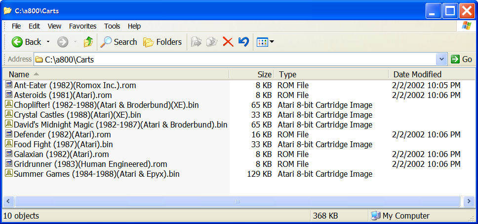

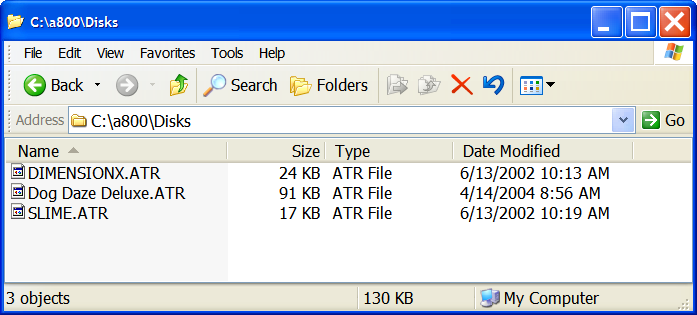

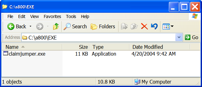

While you are at it, create a folder named SUPPORT inside your A800 folder to store your support ROM image files, a folder named CARTS to store your game cartridge ROMs, a folder named CASS to store your game cassette ROMs, a folder named DISKS to store your game disk ROMs, and a folder named EXE to store your executable game ROMs. After you have created your folders and have placed all of the ROM files in their respective locations, your A800 folder hierarchy should look something like the following:

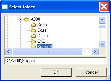

In the second page of the Setup Wizard we must specify the path to our Atari OS and BASIC ROM images. Although you can click each button in this window to browse for your support files individually, because we placed all of these files in a single folder it is much easier to click Search and point the emulator to our SUPPORT folder.
In the Select folder dialog box, browse to locate the SUPPORT folder and then click OK. When you see the Setup Wizard dialog again, it should be populated with the correct paths to your Atari support files.

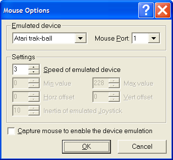

You can also instruct the emulator to capture your mouse for use as a control device (this is particularly useful for trakball games such as Centipede). To do this, Click Input => Mouse device and select the Atari hardware to be emulated by the mouse.
Next, after you've loaded a game you can either click Input => Capture mouse or you can press F12 to capture the mouse. Note that once you have captured the mouse you'll have to press F12 again to release your mouse from the emulator! You can tweak mouse-emulator settings by clicking Input => Mouse.

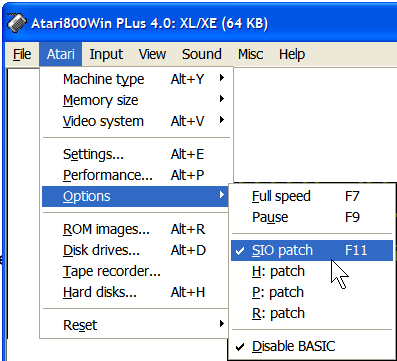

Click Atari => Options to disable BASIC (required for some games), increase the speed of the emulation, pause the emulation, and configure various patches.

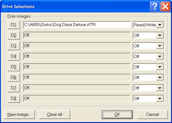

Click Atari => Disk drives to open the Drive Selections dialog box. From this dialog box you can use the D1 through D8 buttons to mount .ATR floppy-disk image files. You can also use the drop-down list box besides each virtual floppy disk drive to specify read/write or read-only drive access. Please note that some 8-bit games require read/write access to the virtual floppy disk.

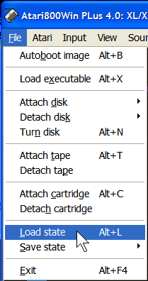

Note that the File menu in Atari800Win Plus includes several Attach and Detach commands, depending upon the type of ROM file under consideration. If you use an Attach command to attach a game cartridge, cassette, or floppy disk image file, then you might have to perform a warm reset (by clicking Atari => Reset => Warm) to force the emulator to recognize the new ROM image file.
Finally, we arrive at the subject of save states. To save your game progress at any time, simply click File => Save state => Normal.
In the Save Atari saved-state file dialog box, use the Save in control to browse to the folder where you want to save your save-state file. Give the file a name and then click Save. The savegame will be saved with the .A8S extension.
To load a savestate, click File => Load state. (You do not have to attach the game media before you issue this command.) In the Load Atari saved-state file dialog box, locate your savegame file, select it, and then click Open. You will receive a message in the emulator window stating Paused (F9 to continue). As soon as you press F9, your savegame will be restored instantly.
